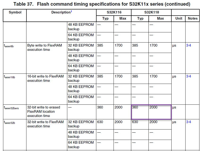

I have noticed that you disable interrupt before each EEPROM write.
Since this eeprom operation can take some time, the interrupts might be disabled for too long.

      I don't think 16 bytes *2000us will be affected when running in a 200ms scheduler.
