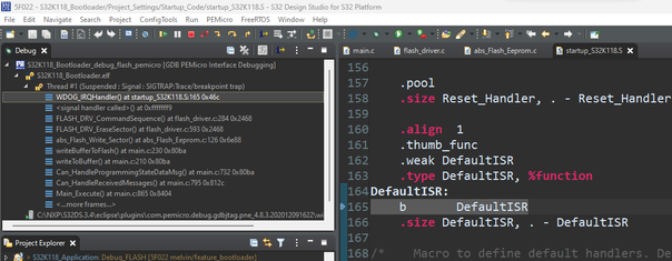

I'm working on a bootloader for a custom PCB with the S32K118 processor. Here i communicate al the data of the hexfile through the CAN communication and write each flash sector to the following address and upwards: 0x20000.This bootloader successfully flashes the communicated data to the flash of the MCU. And if i jump to the application that is flashed it seems to work fine.

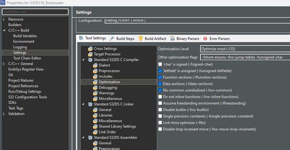

But when i change the optimization level of my bootloader code from none to for example -O3 like below in my build settings:
Something strange happens in on of my methods:

When this method is called the and i run the debug with my Universal Multilink Debug probe its shows that is crashes and goes to the default ISR. And when i place a breakpoint the FLASH_DRV_EraseSector() returns a STATUS_ERROR.
When i unplug the debug probe restart the pcb and run my code without debug. The same fault seems to happen when i start to flash my hexfile to the device. Because is can see it stops working on the same spot.
I'm not sure why this is happening. I've read that uninitialized variables can cause this behavior, but i made sure that everything i could think of is initialized.
Does anybody have a clou what can be the cause of this? Any help is greatly appriciated.

melvinw
Thx i will have a long look at it! Until now i haven't found a flag that is causing this problem. Are there other compiler unrelated options that i might want to take into consideration that could cause this kind of behaviour?
Best Regard,
MelvinW

melvinw
Hola, lo he arreglado. Ahora solo uso Optimizar (-O1), ya que otros niveles ya no optimizan mucho. Y los niveles de optimización más altos significaban que la funcionalidad que necesitaba en mi código ya no funcionaba. Espero que esto ayude.

Hi @melvinw
As it is said in the post shared before: "when your application becomes complex, and the optimizations start harming the overall functionality of your application. This is related to the optimizations that are being done, meaning the code was written to work as one thing, but the optimization changes the overall logic (due to the changes creating a better performance, changing memory accesses and implementing optimized loops), and this new logic can happen to be not compliant with what the original idea was, hence harming functionality.
As for performance, each level will create a different kind of optimization related to loop-unrolling, memory access pipelining, and so. Given that -Os is related to size and -O3 is related to more optimizations, we can assume that -O3 should have a better performance than the -Os one.
Still, the optimization level is to be taken with care, given that a -Os optimized application can be running as expected. However, once you up the optimization to -O3, the application can fail due to non-compliant behavior.
Again, this is more related to the compiler itself, rather than the NXP products. We might recommend talking a look into the different optimization flags and see if any of them can be non-compliant with your application."
