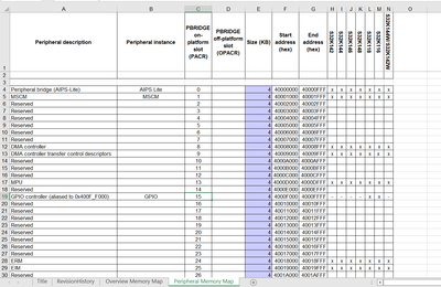

Hi @LijieDu,
It is protected by the AIPS.
Have a look at Peripheral Memory Map in the S32K1xx_Memory_Map.xlsx file that is attched to the RM.
PortA is configurable in PACRF[26-24].
You would need to clear OPACRF[26].

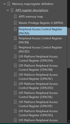

PACRF register not found in the reference manual Rev13 below:
I can't understand the memory mapping table. Can you explain how to map one to one in detail

Hi @LijieDu,
Sorry, I meant OPACRF.
OPACRA[SP0] is FTFC
OPACRA[SP1] is DMAMUX
OPACRF[SP1] is PortA
BR, Daniel

LijieDu
hi @danielmartynek
Thanks for your reply
Sorry, maybe I didn't describe the problem correctly,PTA type is GPIO_Type defined in s32k118.h
According to your prompt,and Refer to map table below, I clear the bit 3 of PACRB and can control IO output in user mode,it did not go to hardfault again
Thanks very much!
