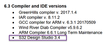

danielmartynek
Hi @Juns,
You just mentioned like 4 different issues.
Initially, you could build it, but the MCU did not work after POR.
As I said, it is either in system reset or stuck somewhere in the code, you need to test it.
And now, you can't even build it.
The SDK verision is supported officially in S32DS 3.4.

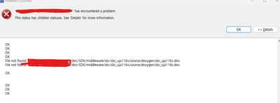

Juns
And when I first launch S32DS 3.5 IDE, it shows a message saying it can’t link the SBC UJA chip. Could this also be causing the issue?
