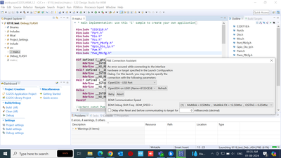

while flashing time I'm getting this type of error u can see the Above the pic plz guide me for Rectify. one time it is working second time flashing means it's not working. that is solution for this

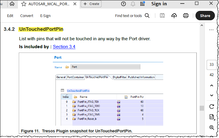

Note that these debug pins should be added to UnTouchedPortPin. Otherwise, you will not be able to connect to the S32K because the debug pins have changed to other functions after the pin initialization is done at power-up.
If so, please try to use the Kinetis_Recovery_Utility.zip mentioned in Can't use PEmicro debugger with S32K118EVB2-Q048

Hi Robin,
thank u for u r reply but without adding the UnTouchedPortPin also previously its working. now its not working currently I'm using S32k118 Board. even though example also we flashed but also same issue.

Hi @Robin_Shen ,
thank u for  fastest reply and Support to wards the solution. currently I'm not using debugger, so I configured Untouched pin still I'm facing same issue. once  its flashing when it suspend or terminated. second time again we need to plugs out and reconnect means it will work later. every time  we need to do like this.
