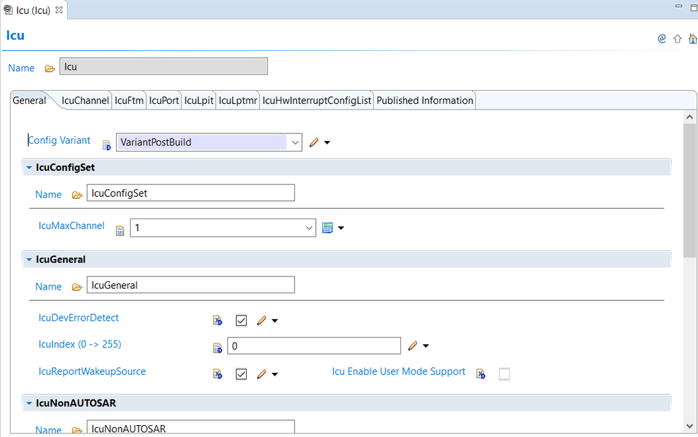

1. Enable ICU module and configure general parameter:

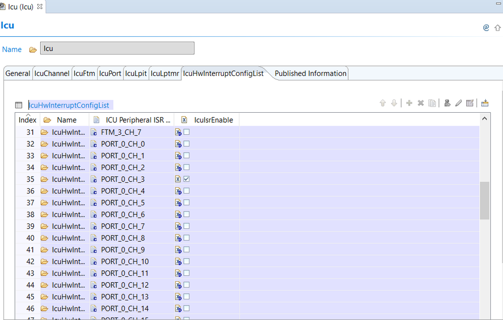

2. In IcuHwInterruptConfigList, add all available options, then tick to the port pin for targetting interrupt handling (for example, tick to the PORT_0_CH_3 for triggering interrupt when Pin A3 is toggled:

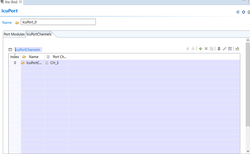

3. In ICU port tab, add the corresponding port pin to the configuration:

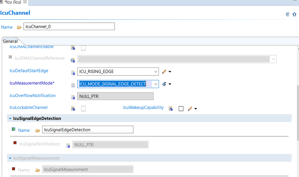

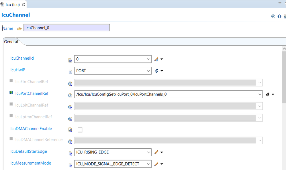

4. In ICU channel, configure ICU signal detection in Port Pin:
Link the IcuPortChannelRef to recent created Port pin channel. Choose ICU_MODE_SIGNAL_EDGE_DETECT in IcuMeasurementMode, and choose default start edge for expecting capture edge signal
Enable the Icu Signal Detect option. You can configure notification callback if desired:

Also, please make sure the option for Port Interrupt is enabled in IcuHwInterruptConfigList:
