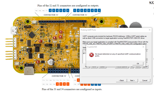

I am currently getting started with the S32K116EVB-Q048 (old version). However, when I try to establish connection to the board in FreeMaster, I always get the error ""No board detected on any of the specified UART communication ports".
I have alredy looked into this discussion S32K116EVB FreeMaster Connection Failure, however I couldn't solve the problem.

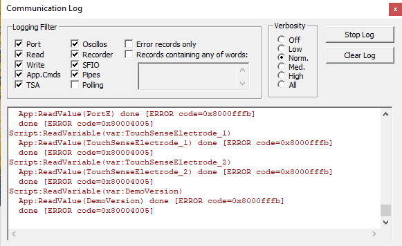

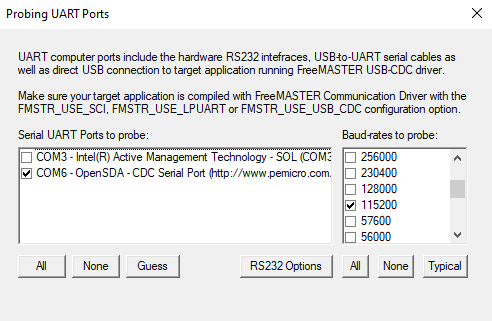

I had already downloaded  S32K116EVB Evaluation Board – Software for FreeMASTER and I did it again but I still can't connect the board.
Attached is the error I get in the Communication Debug Log and Connection Wizard.
I do have installed the most recent version of SD32 Design Studio, I don't know if that can influence the connection in FreeMaster.
Thank you.

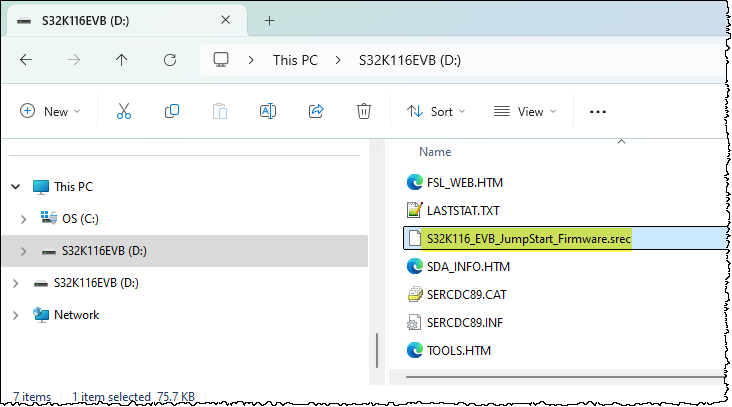

Did you drop the S32K116_EVB_JumpStart_Firmware.srec(...\S32K116EVB_JumpStart_FreeMaster \S32K116_EVB_JumpStart_Firmware\Debug) into mass storage device?
After this, the RGB LED will blink.
