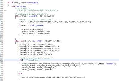

I faces a timeout problem in my LIN slave application that I use s32k116 MCU. I am using LPUART1 for LIN communication and when it responses to  a LIN header, after sending first data byte, it stops sending but "LIN_TX_COMPLETED" event does not occur. I have doupts on the LIN library because when I debug it , it goes only once to the  "LPUART_Putchar" function. I am sending response to the header inside the LIN callback function. Can you please help me!

do not manually send characters, use driver api. Just prepare response buffer and use LIN_DRV_SendFrameData as it is shown in example. Checksum is calculated within interrupt handler.
BR, Petr
