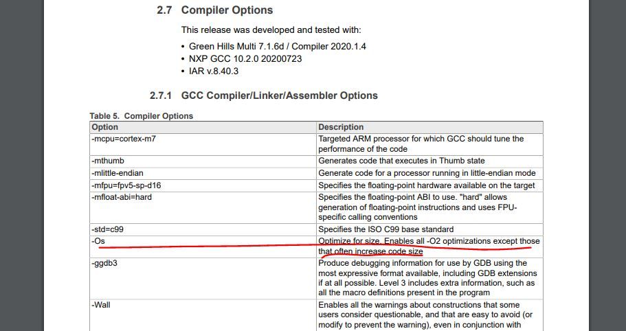

We have gathered the compiler optimization settings for both the SDK-based software (S32DS 2018.R1) and the RTD-based software (S32DS 3.5). Please find the attached zip file of  screenshots for reference.
Additionally, we made a change in the RTD-based software optimization from Os to O2, and we observed a difference in flashing behavior. The updated flashing logs for both the older and modified settings are also attached.
Could you compare the compiler optimization settings between SDK and RTD-based software and suggest any necessary changes to align them for better performance?
and also are there any additional settings we should modify to ensure proper execution in RTD-based software?
because after changing the optimization from OS to O2, we saw the difference and think optimization has something to do with this issue.
1,401 Views
Senlent
Hi@AdithyaJayaram1996
I don't have more experience with this。
If the compilation options help your problem, you can try different compilation optimization levels, such as -O1, or even -O0. If this is indeed a problem caused by the compilation priority, then you should check your protocol stack. At least the routines we provide currently support -O2 optimization level.
You can have a try below settings, if still can't work as expected, then you can try -O1,or even -O0
1,197 Views
AdithyaJayaram1996
Thanks for all the suggestions provided by you, It really helped us to figure out the root cause for the issue we were facing
Is it possible to provide any documentation that is available for GCC 10.2 for Arm 32-bit Bare-Metal and similarly for GCC 6.3 also
and also it would be great if some compiler expert from your team could look at the documents that I've shared erlier with you and suggest us with right set of optimization
1,177 Views
Senlent
Good to hear that,
you can find this document in the path shows in the picture.
Also, i have attach it for your reference.
No expert can directly advise you on how to configure optimization options for your code.
This usually requires you to perform compliance testing on your code yourself.
1,156 Views
