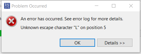

I wanted to try out the LIN STACK example for S32K144, but when I try to open the .mex configuration file, this error shows up
I think the issue might be somewhere in the configuration file, because some MCAL components (Dio, EcuM and Gpt) are missing in the Peripherals Tool, even though they are configured in the file. Middleware tab is empty as well (even though it is populated in the .mex file). I'd be very grateful if anybody could help me fix this issue.

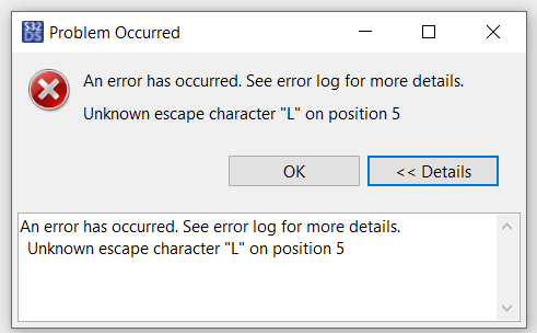

clicking the details just shows the same message again:
here's the error log output if it will help:

UPDATE: I tried manually removing the linstack_config instance from the .mex file and then opening it and the error disappears and the other components are displayed correctly, if the example works in your case, could you please send me the .mex file so that I could try comparing if there's any difference? I have no idea what else could be causing this issue
ANOTHER UPDATE:
I found the culprit
This reverse backslash was causing the issue.
