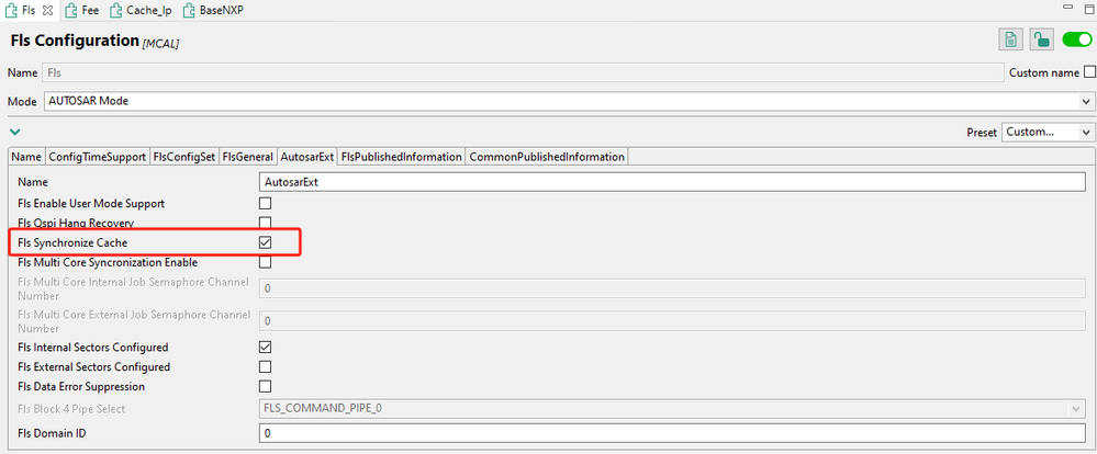

Shaun666
@danielmartynek  Hello Daniel, thank you, this is useful for enable sync cache.
but I have a problem when the code generated.
I only enable the Fls Synchronize Cache option and generate code, only a code changed as shown below in the C40_Ip_Cfg.h
/* Enable the use of cache invalidate */
#define C40_IP_SYNCRONIZE_CACHE             (STD_ON)
I got a build issue for CACHE_IP_CORE  CACHE_IP_DATA at below code.
#if (STD_ON == C40_IP_SYNCRONIZE_CACHE)
static inline void C40_Ip_SynchronizeCache(uint32 Address,
                                           uint32 Length
    /* Invalidate cache */
    (void)Cache_Ip_InvalidateByAddr(CACHE_IP_CORE, CACHE_IP_DATA, Address, Length);
#endif
then , I enable the cache support in Cache_Ip config, but without any code change when I generate code. I don't know why.
 finally , I manual change the CACHE_IP_IS_AVAILABLE to STD_ON in Cache_Ip_Cfg_Defines.h. and build succeed. the Issue have been fixed.
/  CACHE IP SUPPORT                              /
#define CACHE_IP_IS_AVAILABLE                        STD_ON
 What is the problem for the CACHE_IP_IS_AVAILABLE config?

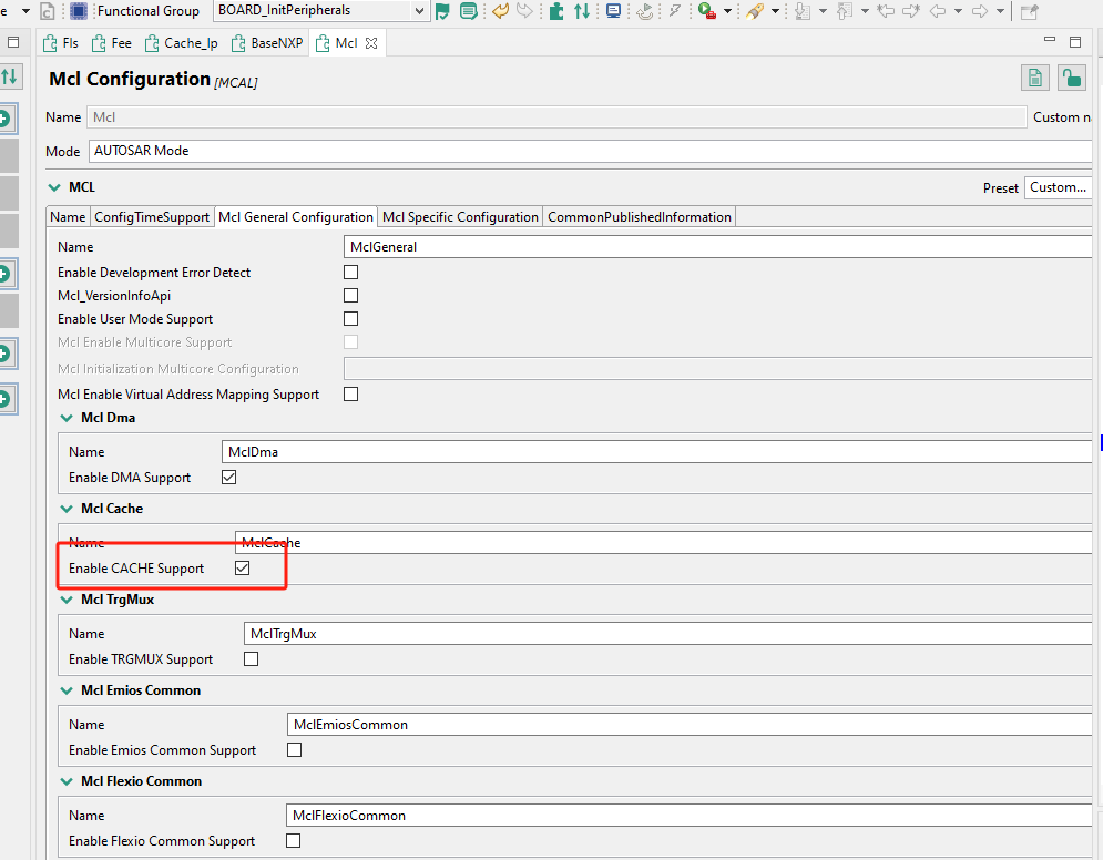

Shaun666
it does need to enable CACHE support in MCL config. thank you.
