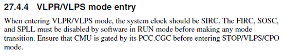

If you use SDK, you can use the power manager driver.
There is this power_mode_switch_s32k144 SDK example for your reference.
The POWER_SYS_SetMode(VLPS, …) function switches the system clock to SIRC and disables SOSC, SPLL, FIRC automatically which is required.
I don’t see this is the steps you posted.

danielmartynek
Which SDK version do you use?
In RTM 3.0.0 and newer versions, the POWER_SYS_SetMode(VLPS, ..) function disables SOSC, SPLL, FIRC and switches to SIRC.
If you don't use SDK, you can refer to
Example S32K144 RTC VLPS
https://community.nxp.com/t5/S32K-Knowledge-Base/Example-S32K144-RTC-VLPS/ta-p/1119655
Can you disconnect the debugger, power-cycle the MCU, and then measure the consumption?

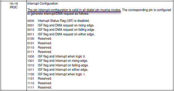

9,101 Views
danielmartynek
There is no need to reconfigure the MUX to GPIO as the pin interrupt works with all the digital functions of the pin.
You just need to enable the interrupt in the PORT module and in NVIC.
