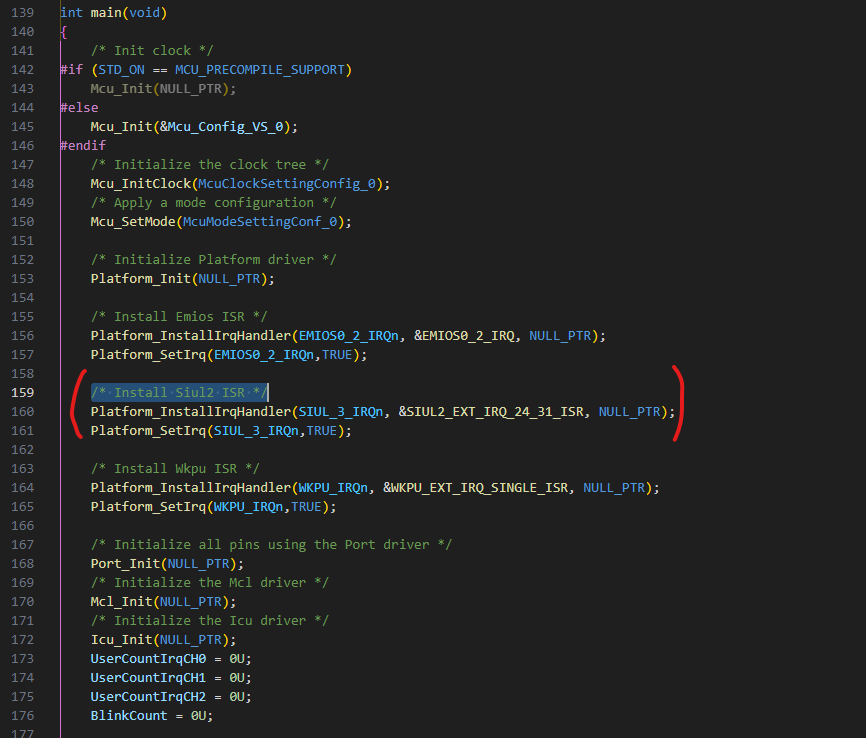

Hi NXP Team,
For a specific use case I wanted to enable and use ICU ISR (SIUL2_EXT_IRQ_24_31_ISR) in S32K342 bootloader project. But I unable find the mapping of IRQ and ISR handler in the example project which i want emulate in bootloader by following the same steps. I found that IRQ configuration are in IntCtrl_Ip_Cfg.c file and it is placed in mcal_const_cfg both flash and sram linker files. But I unable to find the link from there to intc_table in Vector_Table.s file where the interrupt vector table is placed. Can you please point me to any document which explains this or If you could tell me it would be great help to complete an pending task.
Looking forward your assistance here.
Thanks In Advance,
bbaskii

Hi bbaskii,
I think you want to understand how to map Irq and Isr with Vector_table, so i will give you an explaination.
As you said, you already found the Irq in file IntCtrl_Ip_Cfg.c, that's correct. You can see we have SuiL Irq from no.53 to 56, which is matching with Interrupt Mapping (attachment from RM), and for Instance 24-31 i'll use SIUL_3_IRQn.
Next we have to map this Irq with Isr (like a callback function), so we have the Platform function doing this

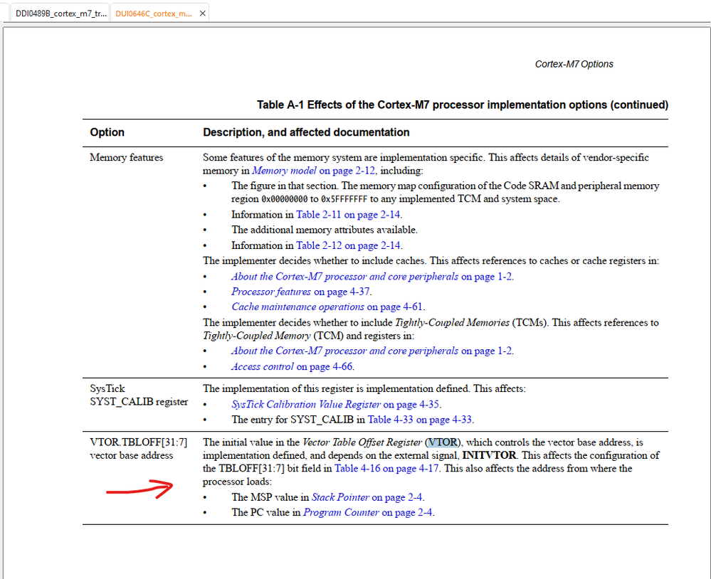

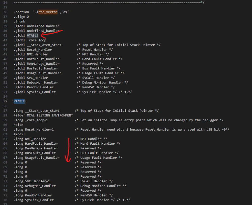

As you can see inside RTD driver, after calling this function, the Isr with corresponding number as Irq will be mapped into Vector_Table through the address that specified defined for chip.

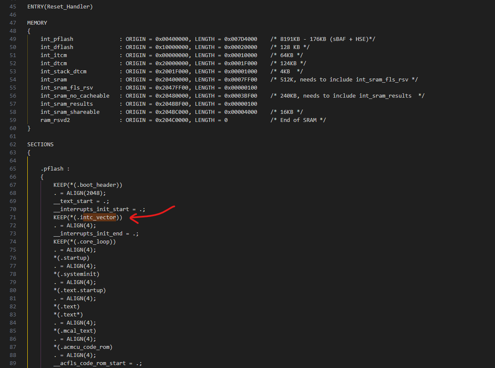

The start address of Interrupt vector table addressed in VTOR register, which follow Cortex M specs.
As you can find, in linker file will contain address of intc_vector, which start in specified address, for example int_pflash area.
And the address of Vector Table will match here.
So that is how ISR works in processing, as you can try to read Platform's functions for those Irq Handler.
