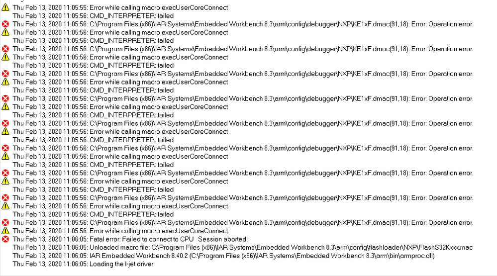

Hi, I encounter one issue about debugging on the development board of S32k144.
The phenomenon is very like the one which posted on below link:
Bricking and Recovering FRDM-KL25Z Boards: Reset, SWD Clock and Low Power | MCU on Eclipse
The possible reason is, i configured the PINS wrongly for the the JTAG pins.
Now, from the experience of others, i need use the tool Kinetis_Recovery_Utility.zip to recover. But i am not able to download the file from pemicro website.
Could you someone suggest some other method to recovery the board or provide me for the recovery tool? Thansk.
The  error information is as below.

Solved.
Downloaded the Kinetis_Recovery_Utility.zip  and recovered the board.
