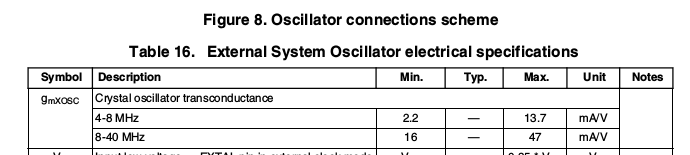

I am looking to clarify some of the crystal oscillator specifications for the S32K.
In Table 16 of the S32K datasheet, several values for g_m_xosc are specified:
I can see that the 4-8MHz vs the 8-40MHz can be selected through  SCG_SOSCCFG (p572 S32K RM), but the datasheet does not seem to provide guidance as to whether the transconductance min/max values of 16mA/V and 47mA/V refer to "low-gain" or "high-gain" operation.
Are there differences in transconductance between these two modes?
Kind regards,
Damien.

Hi Damien,
Those two different transconductances are corresponding to SOSCCFG[RANGE].
The g_m_XOSC would be changed by the SOSCCFG[HGO] setting, but it would still be within the specified min/max range.
With the setting SOSCCFG[HGO]=1 is add an external feedback resistor and  SOSCCFG[HGO]=0 means without external feedback resistor.
I hope it helps you.
Diana

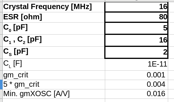

Could you tell me which parameter is making difficult to achieve the minimum gmXOSC?
Could you please fill the required parameters in the attached excel sheet? It can help you to calculate the gm_crit.
Diana

The good news is your spreadsheet is similar to what I have previously calculated and it shows sufficient gain margin to use the low-gain mode.
However, there are still a few open questions:
 - What role, if any, does the pad resistance of 40R (See Figure 8) have on the gain margin?
 - If high-gain mode is selected, what is the minimum transconductance?
If a minimum transconductance figure cannot be guaranteed in high-gain mode (other than the figure in low-gain mode), why have it at all?
