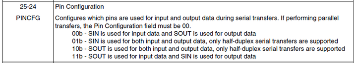

I want to use S32K148 LPSPI module to communicate with a RF module. I don't want to use SDK or RTD drivers. The module interface is based on 3-wire SPI (half duplex). The communication method is that first I send a byte(register address) on the data line and then the slave module puts a byte(register read data) on the SDIO (data line) in response.
The image below is a part of the slave module datasheet. As shown in the picture, the manufacturer recommends that the MCU changes the state of its data line to the input before the last falling edge of the clock, so that it does not overlap with the time, slave turns to output state (which occurs after the mentioned falling edge).
As I have specified in the image above, I assume that the MCU changes the state of the SDIO line to input, after the recommended edge, and there is an interval of time in which both sides are at output state.
I want to use the register level routine, introduced in this topic. What should I do to make sure that the warned contention will not occur on the SDIO line?

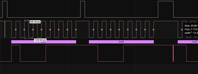

Logic analyser Capture:
Can you please let me know why isn’t the CS extending for the TXMSK byte?

danielmartynek
Hi @Vijay_Arwapally,
I modified the project (attached), especially the LPSPI1_ReadReg() function.
I get 0x8F80 on the bus.
Probably because I don't use any slave on the bus and the data line slowly discharges.

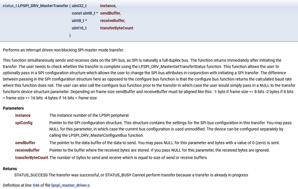

danielmartynek
You can pass NULL to the receiveBuffer parameter.
And you don't have to use any pin for the MISO signal in the PORT module.
15,540 Views
Vijay_Arwapally
@danielmartynekThe communication to the interfaced sensor isn't unidirectional. S32K has to send and receive data from the sensor, as specified in the diagram.
Passing a NULL to receive isn't valid, basically the master still need to provide clk and cs while the data line is driven by slave.
Your answer doesn't seem to right in this context.

danielmartynek
I see, thank you.
The SDK does not support that but the LPSPI module does.
Please refer to the RM.

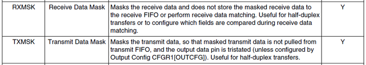

Vijay_Arwapally
@danielmartynek:
Can you provide some additional information abt these register fields? how should they be controlled in below situations?
1. S32K sends 'n' bytes data to Sensor, no response expected.
2. S32K sends 'x' bytes of command, expected 'n' bytes response from slave, additionally PCS line shouldn't be re-asserted.
15,523 Views
danielmartynek
You need to use different commands for the operations.
Please note that the Transmit Command Register (TCR) is not just a register, it is a FIFO, so do not use read-modify-write operations on the register but write the register with 32bit words.
In order to send data, first write a command with RXMSK set and then all the data to the Transmit Data Register (TDR).
To receive a frame from the Slave device, write a command with TXMSK set.
Please read Section 51.4.2.1 Transmit and Command FIFO commands in the RM.
