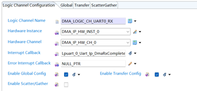

I create a project for S32K144 base on platformSDK_S32K1_2021_08_S32K144_M4F, and configured the MCAL which the LPUART transmit via DMA. The tx Interrupt could generate but when I send massage to MCU via other tool, the Rx interrupt could not generate. Now I could not receive uart message with non-blocking way.
Is there any way to deal with it?

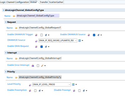

You don't need to enable the Scatter/Gather. Please follow part 3.3.3 DMA configuration in the RTD_UART_IM.pdf file to configure the UART transmission using DMA method (It's for EB Tresos but the same things are apply to S32 Design Studio - DMA_IP)

I did what the IM manual said, the configuration as below. It still could not  generate the receive interrupt unless I call the receive function forwardly.

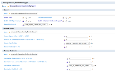

On the other hand, the configuration of  Transfre Container is the default setting, is there any reference for that how to configure this container ?

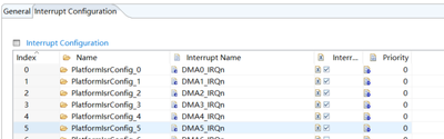

Did  you enable and configure the DMA interrupt handler accordingly? I supposed you don't need to configure the transfer config since they are configured internally in the LPUART driver. What you need to do is configuring the DMA HW logic instance in Global tab based on what is written in the IM.

I did enabled the DMA interrupt and the handler

The interrupt configuration is correct, and it could receive message sometimes which asks me to Receive forwardly.
I am confused that how to configure the Dma Logic Channel Rx  of MCL instance in EB, should I enable the Scatter/Gather, and if so, how to configure this part?
