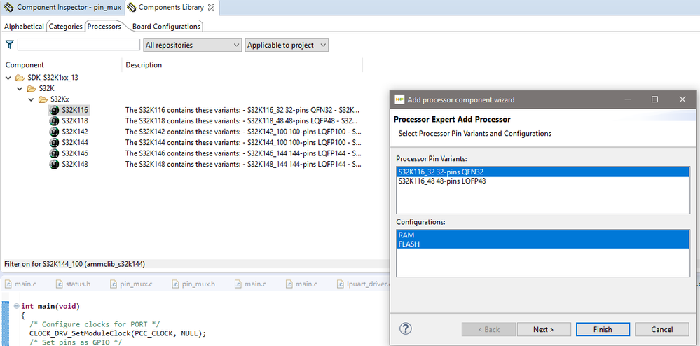

IS Here An Update To S32K SDK For S32K116 32P Processor Expert? We Don't See 32P Processor Expert In SDK.
Can Anyone Provide It?
1,576 Views
raresvasile
You can find the CPU derivative in Components Library -> Processors -> S32K116.
