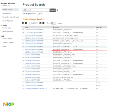

Hello NXP bro,
I wanna ask a question. I installed the RTM version 4.0.1, but I search the RTM on the offiical web. I find the the version is 4.0.2. I use the S32DS3.5 .
What Is any differences between the two versions?
there is no zip/rar download pack, just only exe?

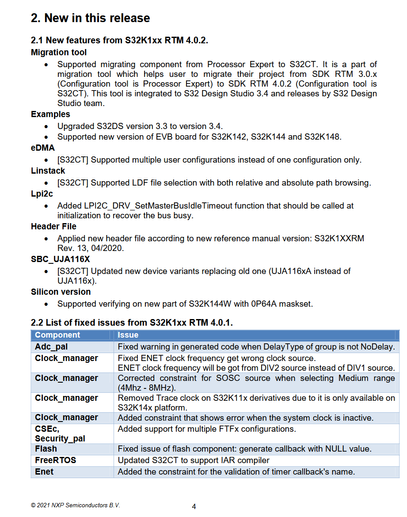

Difference is state in release notes:

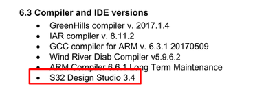

I see the download packages in NXP software account only for EB tresos (*.exe) files.
So the SDK will be available in S32DS extension and updates directly.
But I see it supports only v 3.4 and not v3.5 of S32DS.

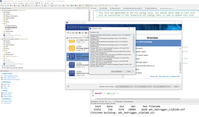

why does my projects base on S32DS 3.5 and it's compiled succeed? I builded a foundation projects based on SDK RTM 4.0.1, but customer can't open my project using S32DS 3.5? customer has no environment to contect Public network.

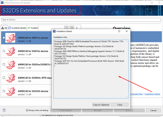

Hard to say. Basically there can be million reasons as there are always issues with S32DS compatibility.
I suggest to check if his installation match yours:
