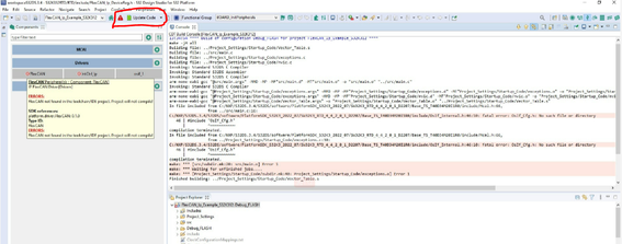

Hi Sir:
IThe chip we use is S32K312,add the FlexCan RTD Driver ,it did not  build success. More inform as below:
Tool:S3DS3.4
RTD:PlatformSDK_S32K3_2022_07   version:2.0.1
the error information as attachment picture error.jpg。
Thanks!

Hi@Bert2023
you may forgot to update code here.

Hi,Senlent:
Thanks for you reply.
I use the  demo "FlexCAN_Ip_Example_S32K312" provided in RTD or New creat a project  and remove the “compatibility.xml” file the error information (Newcreat.jpg),the demo error inforation (FlexCAN_Ip_Example_S32K312.jpg) as attachment picture.

Hi Senlent:
It‘s ok after update code。

Hi@Bert2023
Can you try to test the demo "FlexCAN_Ip_Example_S32K312" provided in RTD?
If this problem still exists,this may be a known bug of S32 DS V3.4 ,please try to remove the “compatibility.xml” located at “C:\NXP\S32DS.3.4\eclipse\mcu_data\configuration.
