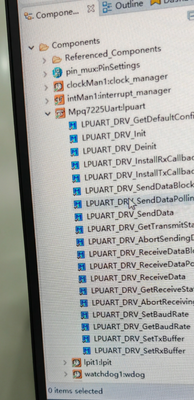

Why is there no this component, I find it convenient to add code to this component but in version 3.4 I can't find it
How to set this up?
S32DS_ARM_V2018.R1                       S32DS3.4

Hi @yff
The latest versions of S32DS come with an Outline view. This displays an outline of a structured file that is currently open in the editor area and lists structural elements (refer attached image).
The elements that are shown in Outline are listed below:
  • Class
  • Namespace
  • Include
  • Enum
  • Enumerator
  • Field private
  • Field protected
  • Field public
  • Include
  • Method private
  • Method protected
  • Method public
  • Struct
  • Typedef
  • Union
  • Variable
  • Function
  • Macro Definition

有没有方法可以把代码拖进工程?我认为那是高效的开发
1,365 次查看
yff
I think it's convenient to drag the code directly in and use this feature, but S32DS3.4 doesn't have this feature?有什么方法可以打开吗?我觉得可以提高效率。

Unfortunately, there is no such feature on S32DS. As far as I know, it is not planned to add something like that.
I am going to let you know your feedback to the corresponding team.
At the moment, the only similar to what you are looking for is the Outline view mentioned before.
