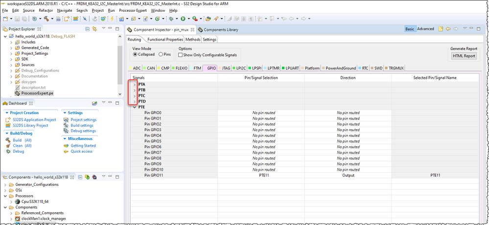

Hello
      Now I use the processor to configure PIN, when I configure the pin PTE11,but the processor will auto refresh, and will show PTA configuration interface, so I want to configure the PTE port again, I should pull down the interface again. This is a waste of my time.
   Is there a Configuration option to put an end to this situation?

Please try:
Robin
3,152 Views
asd046012
Hello
      This is a temporary solution, I re-install S32 design studio, This situation disappeared.
       I didn't know why!
3,136 Views
Robin_Shen
If this problem occurs again, it is recommended to record the screen and upload it to me, so that it can be reported to the IDE team to check the reason.
