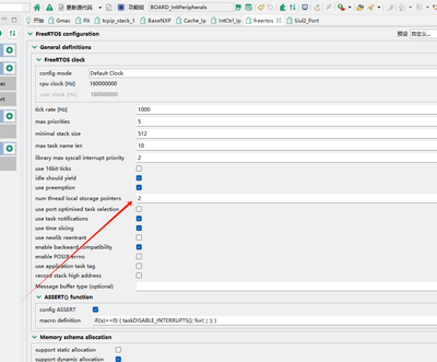

I am using the IDE's own tcpip_stack, after loading the components and configuring the relevant Settings, the compiler appeared the problem, trying to find the cause, and finally did not solve, want to ask NXP engineers, the problem is not because a setting is not paired, resulting in errors, please help to point out, thank you ~
3,457件の閲覧回数
shunyizhang
I've solved the problem. This place can't be zero.

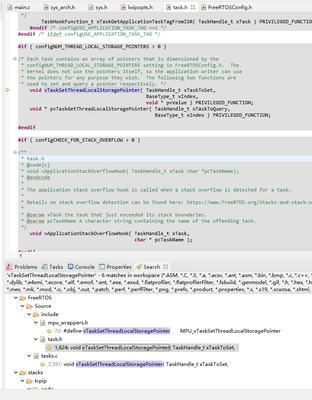

Please help me try workaround this error by delete this warning flag

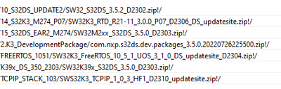

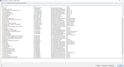

Please give me exact version of RTD and tcpip_stack version that you're using. About DS, which update site version of DS that you've installed?

The compiled project is my own creation, RTD, S32DS, tcpip_Stack version see the picture above.

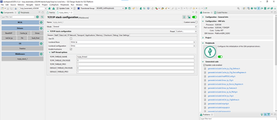

Yes, I am creating a tcpip project based on S32K314; Since the company's computer has encryption software, I can't share my project for you to review, but I can share the screenshot to you, see the picture above, I only added these components, after the configuration, the initial compilation alarm appeared, but I repeatedly consulted the contents of the components, and never found the configuration that can eliminate the alarm.

Got it. So can you show me the declaration of function vTaskSetThreadLocalStoragePointer?
Is that one of driver's stub functions?
Thank you,
Nam.
3,529件の閲覧回数
shunyizhang
Is that it?

I checked with the lwip example and compile it, i added RTOS simply like you. The compiling done without errors.
I installed K3xx dev package, K3 3.0.0 P07, DS update site 3.5.2, service pack EAR2, then RTOS 10.5.1 and tcpip_stack 3.1.0
Did you tried with K344 one? Is that the same issue happened?

Also, please help me to try:
- Increase this param higher than 0.
- Remove Warning flag mentioned in compiler errors.
Thank you,
Nam.
3,458件の閲覧回数
shunyizhang
