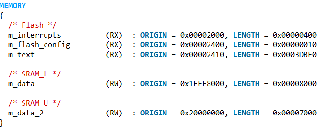

Some tips which helped me though:
First of all you need to compile your custom code to one of the memory locations so the linker file of your custom code needs to be updated as follows:
The independent code example however assumes the interrupt table was placed at location 0x00000000 and manually relocates it.
To disable this functionality simply comment out the following lines from the function below:

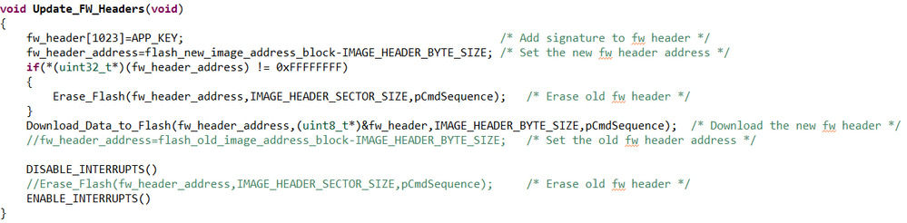

But be careful because in the Update_FW_Headers function the old header (which is equal to the new header in our case) is being erased. So to prevent this behaviour also comment out the lines seen below.

s_verhoek
Dear NXP community,
I have fixed the issue and I am now capable of booting my own position dependent code from one fixed location. (The issue came down to not relocating the interrupt table as was done in the application note and probably the build that was not properly containing a new software version).  Also viewing the actual memory of the EVB with S32DS helped greatly.
I am still looking for a way to generate position independent code. So any help in that regards is greatly appreciated.
