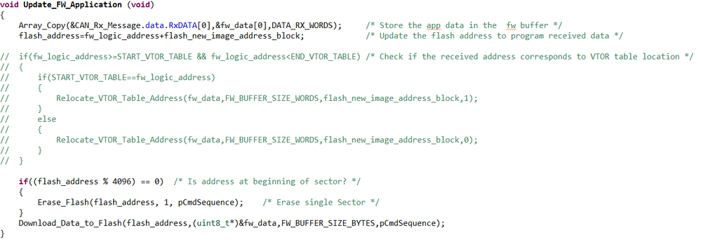

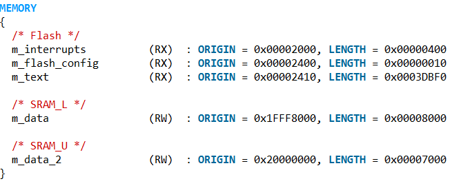

First of all you need to compile your custom code to one of the memory locations so the linker file of your custom code needs to be updated as follows:
The independent code example however assumes the interrupt table was placed at location 0x00000000 and manually relocates it.
To disable this functionality simply comment out the following lines from the function below:
In the void Flash_Block_to_Update(void) function I set the old and new address to always point to block A
Using:
flash_new_image_address_block=FLASH_BLOCK_A_ADDRESS;
flash_old_image_address_block=FLASH_BLOCK_A_ADDRESS;
/*Add image header offset */
flash_new_image_address_block=flash_new_image_address_block+IMAGE_HEADER_BYTE_SIZE;
flash_old_image_address_block=flash_old_image_address_block+IMAGE_HEADER_BYTE_SIZE;
But be careful because in the Update_FW_Headers function the old header (which is equal to the new header in our case) is being erased. So to prevent this behaviour also comment out the lines seen below.

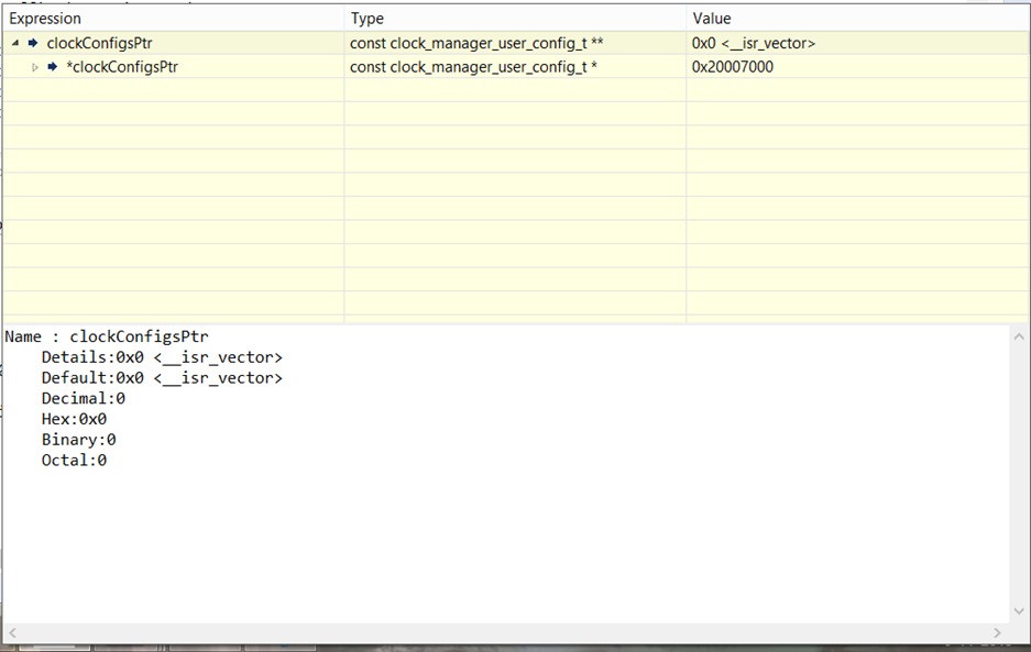

s_verhoek
Dear Rares,

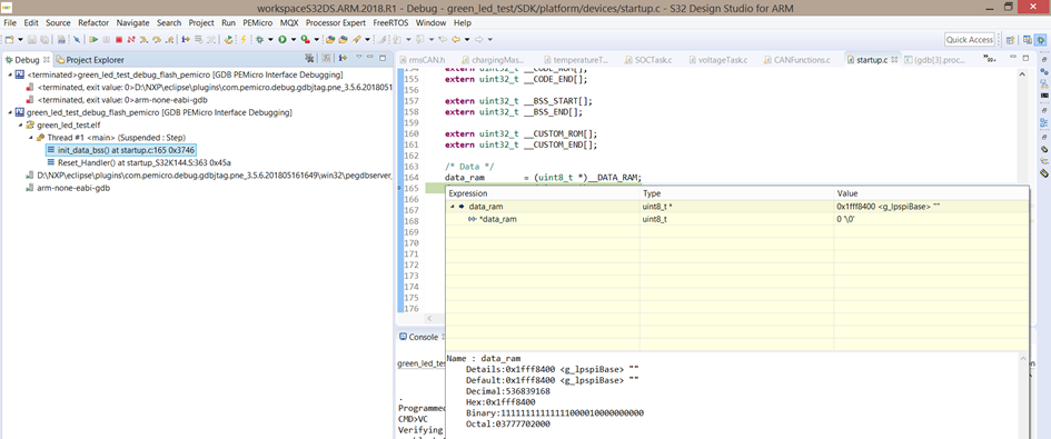

It crashes at "DEV_ASSERT(clockConfigsPtr != NULL);"
Which makes sense looking at the picture below. But how can I make sure it is not NULL?
Kind regards,
Sebastiaan
14,758 Views

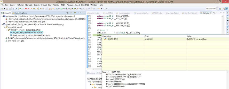

raresvasile
Hello Sebastiaan,
Can you check in init_data_bss function if the data section is initialized correctly?
Thank you,
Rares
14,758 Views
s_verhoek
Dear Rares,
I am not 100% sure what I am looking for as I do not have a whole lot experience with this.

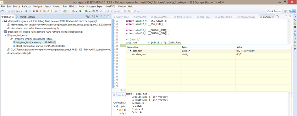

I set a breakpoint at the init_data_bss()  (not sure if this correctly works) but when stepping through the code and checking the variables (again not sure if debugging works properly at this stage in the program). But on line 164 of startup.c:
data_ram        = (uint8_t *)__DATA_RAM;
The right side seems to be initialized see image below.
But the left side after stepping to the next line still seemed uninitialized (see below): pastedImage_2.png
Is this indeed the problem or am I trying to measure something that cannot be measured. When I am not using the -fpic tag or -fpie tag data_ram will be assigned the same value as __DATA_RAM (see below). pastedImage_3.png
If this is indeed the issue then how can I solve it?

jorge_a_vazquez
Hi Sebastiaan Verhoek
The problem is the access to the global variables, the instructions of the code are indeed compiled independent to the address, but the global variables have to be accessed with the GOT (global offset table), the __DATA_RAM is an extern global variable, so it doesn't know the location of this variable. Unfortunately, this implementation hasn't been done in S32DS.
Jorge Alcala

I have updated the flash.ld of the simple program file to be the following:
The bootloader application is updated to always place the application in block A and also jump to location A:

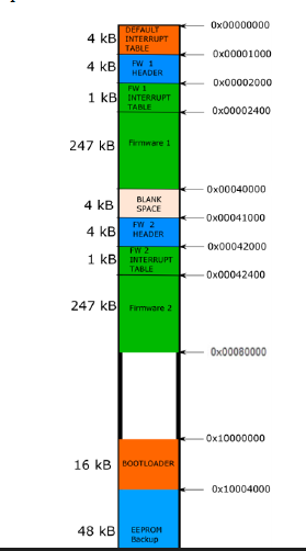

To match the Firmware 1 location linked below (being location A).

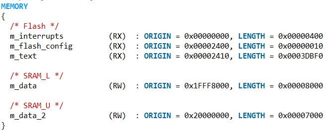

The interrupt vector is placed in location 0x00000000 due to the following comment in the application note:
"Addresses in the interrupt table are not affected by the ropi and remain the same as declared in the linker file. To solve this, the interrupt is located starting at address 0x00000000 as by default in the linker file, and then an offset address must be added to each entry of the interrupt table during the update process, except for the first entry that is the stack pointer. The address offset value depends on where the new firmware will be in program flash. Hence, when an interrupt happens, core jumps to the exact location in program flash where the application firmware is placed."
But placing the interrupt table at location 0x00002000 yielded the same result.
