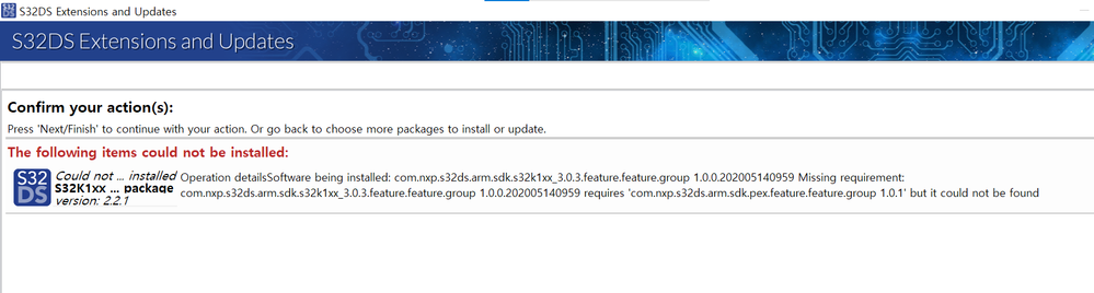

Jackson_Hwang

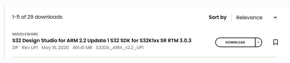

I'm trying to install the sdk3.0.3 update file in s32ds tools, but it fails to install with the following error.
If it doesn't work online, I downloaded the update file from the site. Please tell me how to install it. Thank you.
