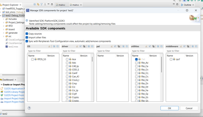

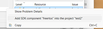

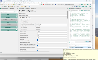

Hi everybody,
I encountered a very strange problem after upgrading to version 7.0.0 with both the RTD driver and FreeRTOS (released a few days ago).
The packages that I have installed are
SW32K3_FreeRTOS_11.1.0_7.0.0_CD1_D2510_DesignStudio_updatesite.zip
SW32K3_S32M27x_RTD_R23-11_7.0.0_D2511_DesignStudio_updatesite.zip
I don't know if this has happened to you, or if it's a bug with the new release.
Basically, after creating a new project, I can't add FreeRTOS as the operating system.
Do you know how to fix it? I'm looking forward to your feedback.
Here are some screenshots:

FreeRTOS team is aware of this issue and they are working to provide a hotfix release by next week.
In order to unblock you, please apply the following workaround to your FreeRTOS installation. Change the version property from 7.0.0 to 4.0.0 in the freertos_itm_manifest.xml file under <DS installation>\S32DS\software\PlatformSDK_S32K3.

Hi Daniel,
Thanks! The workaround solved the issue.
Appreciate your help.
