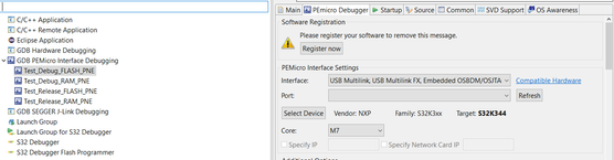

Which worked fine until the debugging process. Where it cant detect my hardware.
I tried to use Ethernet as an Interface and also the J74 Type C Connector.

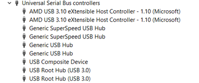

Are there any Drivers I have to install? My Device Manager doesnt update if I plug the USB-C in.
What are the steps so my S32 Studio can detect my S32K344 Device?
EDIT1: To be clear I don't have a PEmicro JTAG connector connected. Is there no Onboard debugging connection?
1,322 Views
danielmartynek
Hello @Ojav,
The S32K344 MCU can be reprogrammed via the J40 JTAG/SWD connector only.
There is no on-board programmer/debugger.
