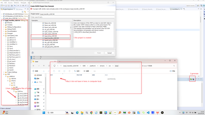

S32 Design Studio  IDE have codes files from example, but it do not exist in the computer local. as follow:
187 Views
lyz
创建的例程SDK代码不会保存在本地,可以自己新建一个APP工程,根据该例程适配各个模块,在generate后,本地就有SDK文件

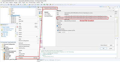

Hi @lyz,
Yes. When importing an example, SDK files are generated as a link, but when you create an application from scratch, you can see the files locally:
Julián
320 Views
Julián_AragónM
Hi @lyz,
The files under SDK folder are not copied into the workspace directory, rather they are linked to the SDK installation:
I guess this is done to reduce space occupied by driver files, so they are not copied for every project every time.
