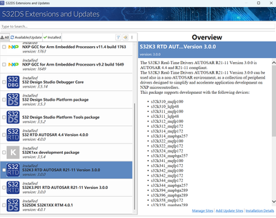

      I want to create an AUTOSAR project for the S32K1 series using the S32DS 3.5 version. However, I couldn't find the corresponding AUTOSAR library for the S32K1 series in the IDE. Could you please tell me if this version doesn't have the AUTOSAR library for the S32K1 series?

If you do not have it on the list, then you can install it manually.
Here is the RTD link:
https://www.nxp.com/design/design-center/software/automotive-software-and-tools/real-time-drivers-rt...
and the tutorial:
refer to offline package installation:
https://community.nxp.com/t5/S32-Design-Studio-Knowledge-Base/S32DS-Extensions-amp-Updates-Explanati...
