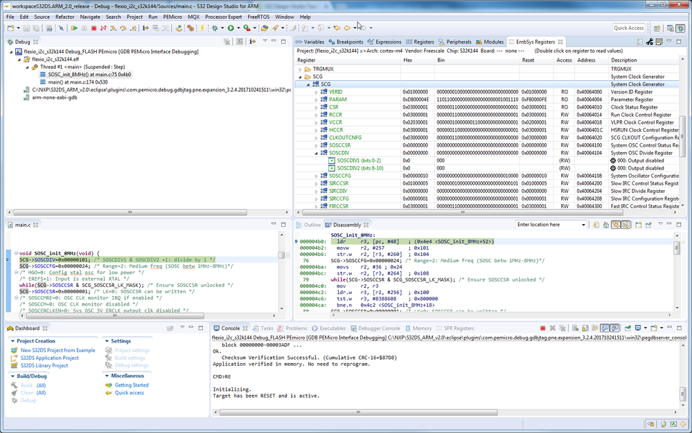

I'm sorry - but I can't reproduce your issue. Did you double click on particular register to view current data? It may not be obvious on first look.
I tested your code - here is state before write divider data:

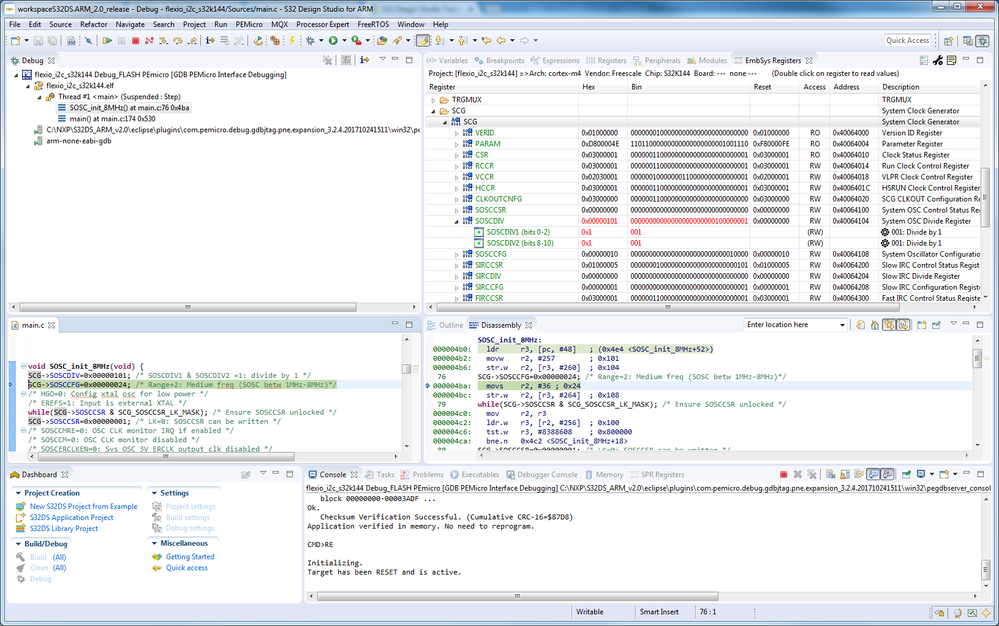

and here step after:
Register value is updated by new value.
I'm using S32DS for ARM v2.0. If you have older one - please update to v2.0. In older versions was some refresh issues (already fixed in v2.0).
