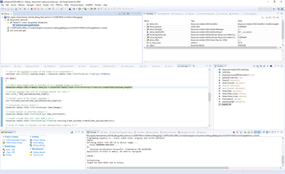

We just received a S32K146 evb board today and I tried running the Libuavcan demo on it. We've been running this demo on the S32K1SIC boards and are able to step through code and debug, but when I try it with the S32K146 board, the debugger won't function and all I can do is terminate. I'm hoping this is something simple, but I haven't figured out what it could be.

I have used OpenSDA USB debug interface, which is integrated on the S32K146EVB.
I do not have JLink debugger, once I will have an option to use it I will try the same.
BR, Petr

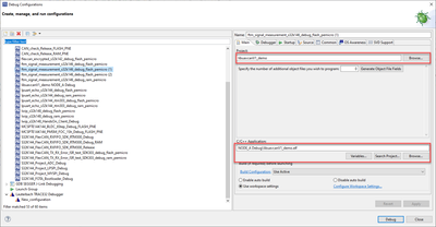

the Libuavcan demo does not include debug configuration, so you need to create new one.
I can recommend to reuse an existing project debug configuration or create a new dummy project for loading .elf/srec/hex.
Below is the config I tried, I copy existing configuration and change path to the generated elf.
I was able to debug project then on S32K146EVB
