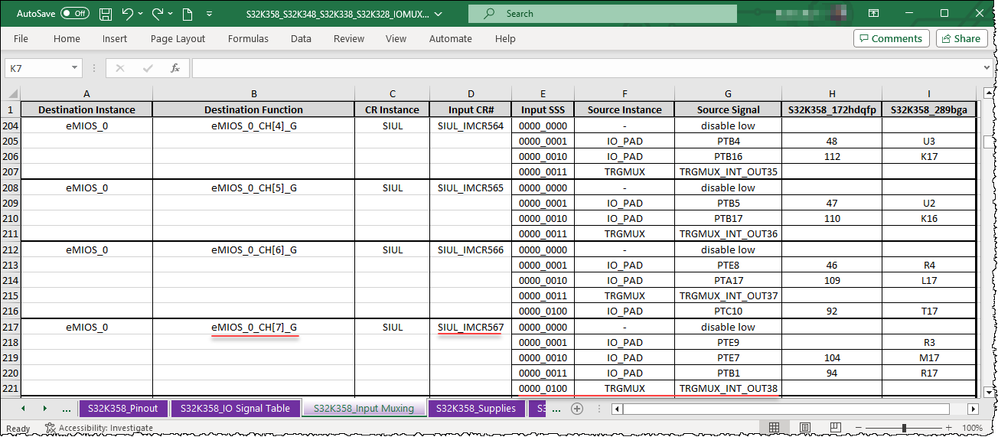

Your project configure eMIOS0_CH7 as eMIOS_Icu, so I chose eMIOS0_CH7 for demonstration. TRGMUX_IP_INPUT_LCU0_LC0_OUT_I1 -> TRGMUX_IP_OUTPUT_EMIOS0_CH5_9_IPP_IND_CH7
// Siul2_Port_Ip_SetTrgMUXInput(564,PORT_INPUT_MUX_ALT3);
Siul2_Port_Ip_SetInputBuffer(NULL, 0, FALSE, 567-512, PORT_INPUT_MUX_ALT4);//eMIOS0_CH7  IMCR567 to 0x4 (TRGMUX_INT_OUT38)
Now, eMIOS will get signals from internal rather than external pins.  That is what you mentioned: My input to EMIOS is LCU_OUT.

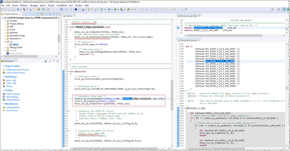

You configure eMIOS0_CH3 to SAIC ICU_FALLING_EDGE and ICU_MODE_SIGNAL_EDGE_DETECT. Then call Emios_Icu_Ip_GetDutyCycleValues(INSTANCE_0, CHANNEL_7, &get_dc) in the Notification of eMIOS0_CH3, which is Driver_Fault;
But why not call Emios_Icu_Ip_GetDutyCycleValues(INSTANCE_0, CHANNEL_7, &get_dc); directly in the interrupt of eMIOS0_CH7?
Please see if the method of calling Emios_Icu_Ip_GetDutyCycleValues in S32K344_Example_Emios_Icu_IPWM_measurement_DS34_RTD_100_v2 with EMIOS_1_ch_1 (IPWM mode) meets your needs:
Emios_Icu_Ip_GetDutyCycleValues Icu interrupt.pngIcuIsrEnable EMIOS_1_CH_1 S32K344_Example_Emios_Icu_IPWM_measurement_DS34_RTD_100_v2.png

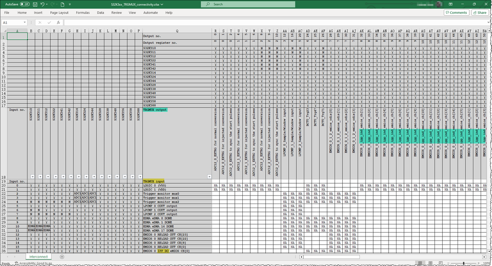

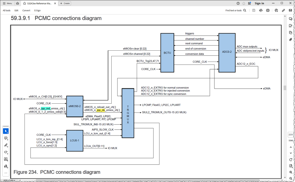

(signal input of eMIOS) eMIOS_n_ipp_ind_emios_ch[ ] can be the output of TRGMUX.
(signal output of eMIOS) eMIOS_n_ipp_do_emios_ch[ ] can be the input of TRGMUX.
I hope this can be explained clearly.

(external PWM signal) eMIOS_n_ipp_ind_emios_ch[ ] can be the output of TRGMUX. It cannot be used as input for TRGMUX. So I don't think the signal input of one eMIOS channel can be routing to another eMIOS channel as input.
If you connect the external PWM signal to SIUL_TRGMUX_IN0-15 (IO MUX), then as the input to TRGMUX, I think you can routing signal to the input of multiple eMiOS channels(eMIOSN_ipp_ind_emios_ch []) by TRGMUX.

My input to EMIOS is LCU_OUT. I have shared the image here. This configuration doesn't return me any output at EMIOS0_4. I am not linking EMIOS input to EMIOS output.
Also, from the diagram you shared, do I need to do any additional configuration for EMIOS_0_4 channel? Because I am not sure if I need to call it in the code in some way, I am directly routing LCU_OUT to it and then taking it at pin output.
