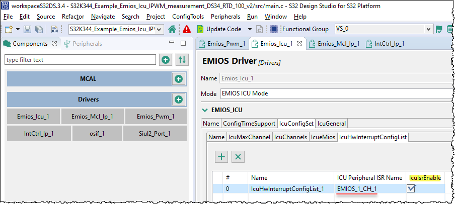

You configure eMIOS0_CH3 to SAIC ICU_FALLING_EDGE and ICU_MODE_SIGNAL_EDGE_DETECT. Then call Emios_Icu_Ip_GetDutyCycleValues(INSTANCE_0, CHANNEL_7, &get_dc) in the Notification of eMIOS0_CH3, which is Driver_Fault;
But why not call Emios_Icu_Ip_GetDutyCycleValues(INSTANCE_0, CHANNEL_7, &get_dc); directly in the interrupt of eMIOS0_CH7?
Please see if the method of calling Emios_Icu_Ip_GetDutyCycleValues in S32K344_Example_Emios_Icu_IPWM_measurement_DS34_RTD_100_v2 with EMIOS_1_ch_1 (IPWM mode) meets your needs:
Emios_Icu_Ip_GetDutyCycleValues Icu interrupt.pngIcuIsrEnable EMIOS_1_CH_1 S32K344_Example_Emios_Icu_IPWM_measurement_DS34_RTD_100_v2.png
