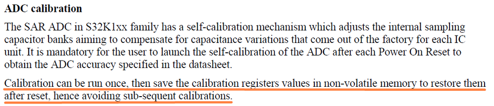

We are working with S32K144 controller for our application, where we used ADC peripheral of controller. Now after ADC calibration when we perform software reset ADC calibration values are lost. So, is it compulsory to perform ADC calibration in all kind of controller resets ? Or Is there something we are missing ?
