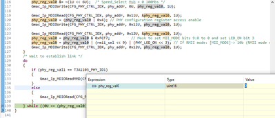

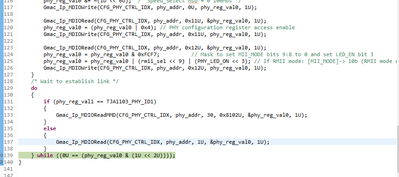

Hello @PetrS, I have run your example (lwip demo included within TCPIP stack) to activate ETH transceiver (TJA1103). However, the link establishment event was not happened.
2,165 Views
PetrS
check for which boards is the example written for and tested on. The T172 has different pinout then the "Q" board, so correct pin configuration should be done as per board schematic. what is your T172 board revision?
Then how do you have board connected with PC? what kind of media converter do you use?
BR, Petr
