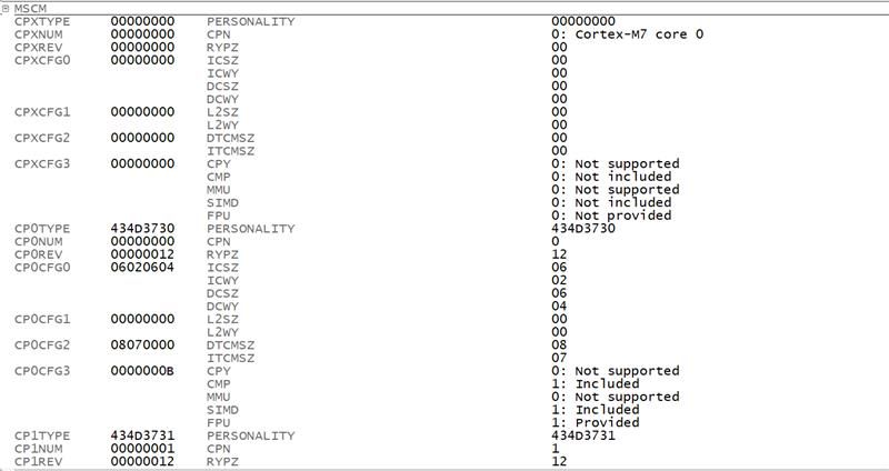

Hi All,
I don't see any register values in the memory in the Lauterbach(LB) (i.e., MSCM base address + offset: 4026_0018h (Processor x Configuration 3 (CPXCFG3))).

Hi Daniel,
I am able to see the values for other registers, except the one starting with CPX, as shown below.

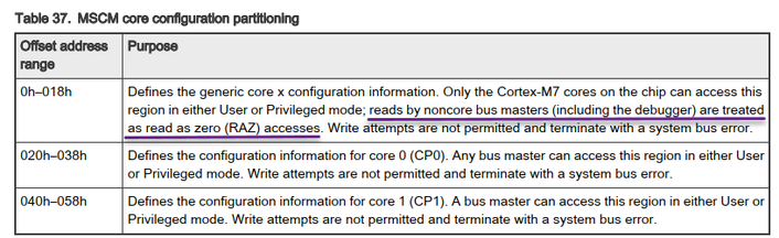

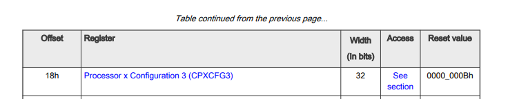

This is specified in Table 37:
BR, Daniel
