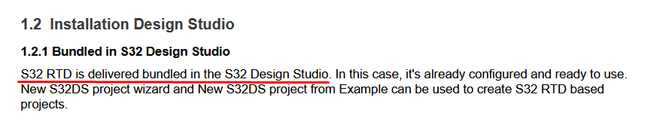

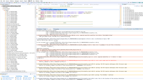

            Let me describe the situation I encountered.I was creating an Autosar project using S32DS3.4. During the process, I encountered errors such as "Cannot find file Os_memmap.h" and other warnings, as shown in the following figure. Then I found the corresponding article on the forum. The cause of this problem is due to a mismatch between the Tresos RTD version and the RTD version installed on the S32DS.The library I use for EB is S32K1XX_MCAL4_2_RTM_1_0_6. For the S32DS 3.4 version, which RTD version should I install?Then where do I need to go to download it?

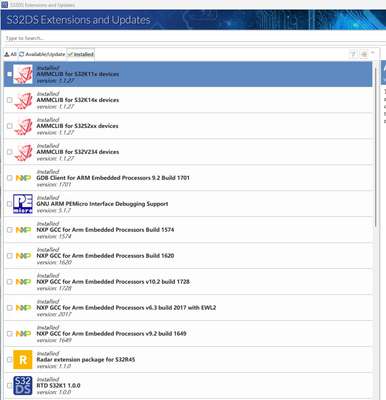

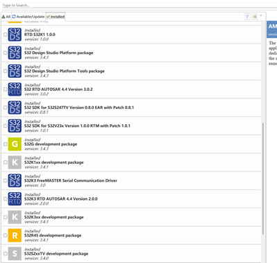

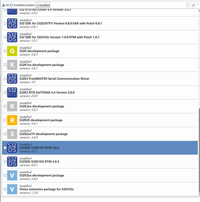

The following are the libraries that I have already installed.
S32K1XX_MCAL4_2_RTM_1_0_6. is some old release as I remember.
S32K1_S32M24x Real-Time Drivers AUTOSAR 4.4 - is latest one for S32K1 and it should be directly in the S32DS 3.6.2 supported.
I recommend you to install new S32design studio version 3.6.2.
Also there you can find the new RTD for S32k1.
