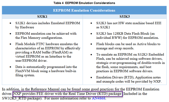

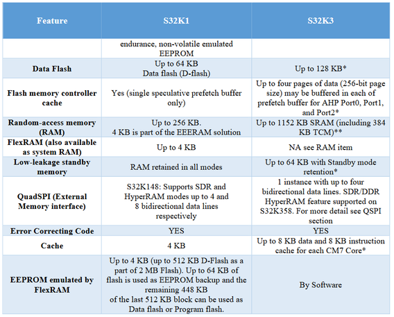

Regarding the emulated EEPROM, it can be done by SW only:
AN13414 S32K1 to S32K3 Migration Guidelines
https://www.nxp.com/docs/en/application-note/AN13414.pdf

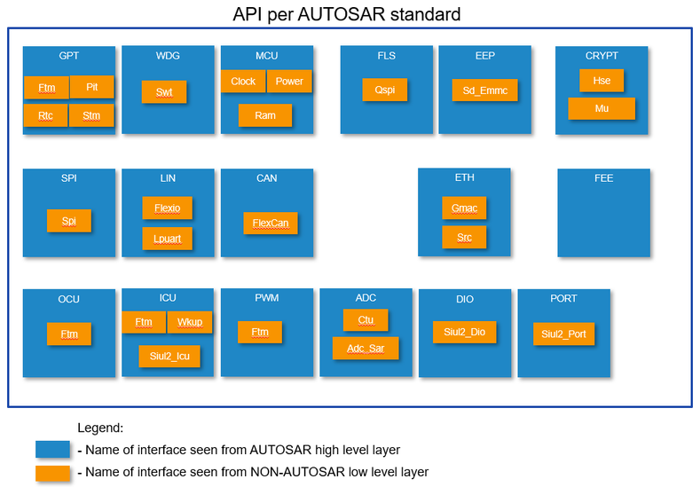

The FEE driver is in the Autosar high level layer

There are Autosar level drivers (like FEE, FLS) and non-Autosar drivers (like C40).
There are these examples in the RTD package:
Example_S32K3xx_DS_C40 (in RTD 0.9.0)
C40_Ip_Example_S32K344 (in RTD 1.0.0)

Is there also the possibility to work with an EEPROM emulation or is there a software driver for this?
