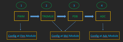

Is there exemple of ADC conversion triggered by PWM using MCAL of RTD ?
Or do you have step by step configuration guideline ? I've read all available examples but didn't find any helping one or example using MCAL from the RTD.
It's a little bit complex to set TrgMux, PDB, ADC and PWM all together using MCAL configurator.
Thanks in advance for your help !

This attachment file is my example of ADC conversion triggered by PWM using MCAL of RTD.

Nice, I thank you !  It seems to be exactly what I need.
