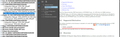

do Crypto_43_HSE, ACE module in  RTD 4.0.0 P04 support S32K312?
which version of RTD support S32K312 for HSE and ACE? Where can I get the docs and samples for application?
Thanks.
440 Views
lukaszadrapa
Hi @BigSun
AES_ACCEL is a HW module which is available only on S32K388. It's not present on S32K312.
Lukas
