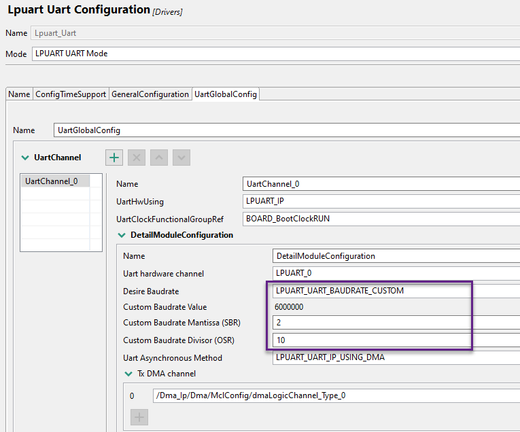

      There's a requirement in my current project. We need high speed of UART.
      From S32K3XXRM.pdf, page 772, it is written LPUART_0 and LPUART_1 is clocked by AIPS_PLAT_CLK, to support up to 12 Mbps while the core is running at 120 MHz, plz can you provide me an example source codes to have a test of high speed UART, if possible at speed of 6 Mbps ? I'd like to know the reg. config to set the baudrate. At my side, I use CH343G a usb dongle that may support up to 6 Mbps.
Thank you so much for your support !
2,751 Views
danielmartynek
Hello @SE500,
You can modify the LpuartFlexio_Uart_Ip_Example_S32K344 RTD example.
Select LPURT_0 and a custom baudrate in the configuration tool.
You would need to modify also the port, interrupt configuration etc.
But at 120MHz = CORE_CLK = AIPS_PLAT_CLK, this would be the baudrate configuration:

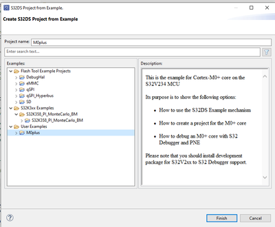

   Thank you for your prompt answer. I can't find the example you've mentionned. : LpuartFlexio_Uart_Ip_Example_S32K344 RTD example.
When I try to create project from example for my board, I only get that :
Is this normal ? What to install to have your example ?
Sry, I've a beginner in S32k products and S32k design studio.

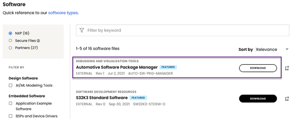

You don't have the RTD installed in the S32DS 3.5.
Once it is installed, you should see it there.
The RTD is S32K3xx Standard SW.
https://www.nxp.com/products/processors-and-microcontrollers/s32-automotive-platform/s32k-auto-gener...
You can follow this guide.
https://community.nxp.com/t5/S32-Design-Studio-Knowledge-Base/HOWTO-offline-install-S32K3-RTD-3-0-0-...

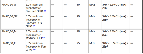

Keep in mind that not all the pins support such a baudrate.
DS, Table 25. GPIO DC electrical specifications, 5.0V (4.5V - 5.5V)
