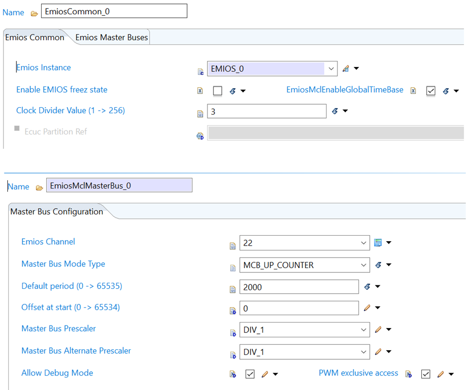

Cpu core clock 120Mhz, Pwm period 50us, Pwm period in ticks 2000.
Mcl module configuration:

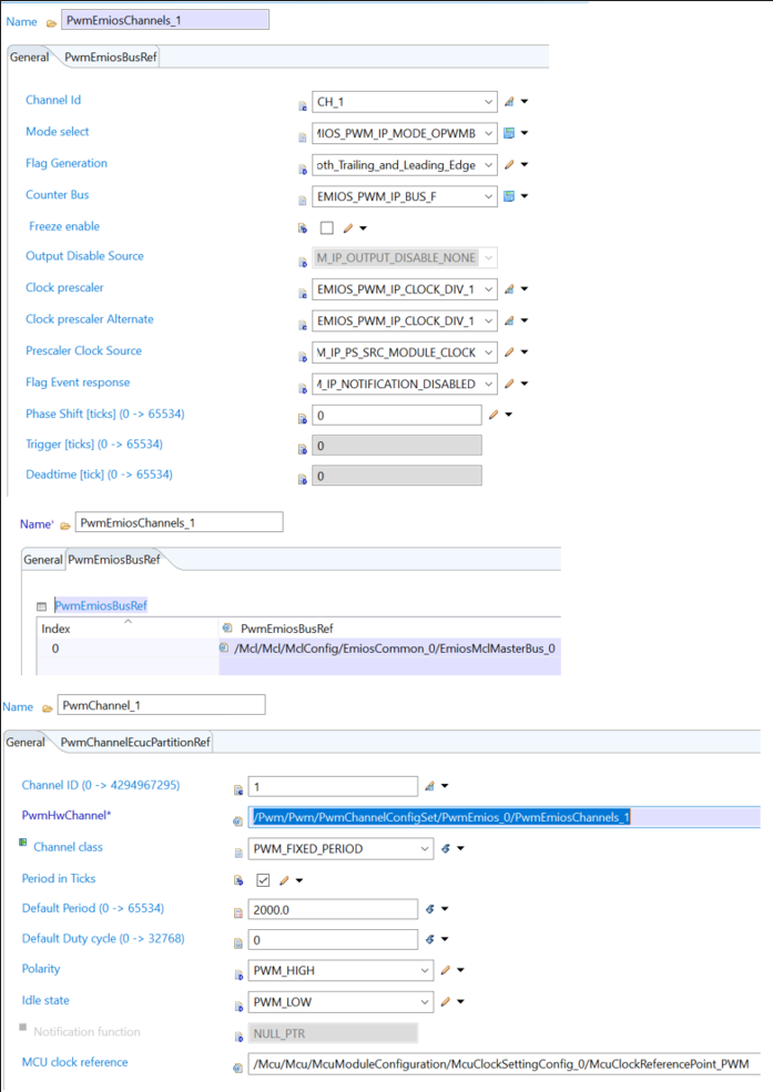

Pwm module configuration:

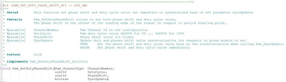

Scenario: Right aligned pwm with 50% duty cycle. Apparently this shall be possible as follows:
Pwm_SetDutyPhaseShift API calls Emios_Pwm_Ip_SetPhaseShift function which increment phase shift value by 1 for EMIOS_PWM_IP_MCB_UP_COUNTER bus mode and writes 1001 to register A for first edge.
Then Pwm_SetDutyPhaseShift API calls Emios_Pwm_Ip_SetDutyCycleOpwmb function which checks if "duty cycle in ticks + incremented phase shift > period" which is always true and then it return error.
Same error happens if I set phase shift 0 and duty cyle 100%, Although from API description these are valid values.
In case of non zero phase shift, a work around is to pass "phase shift -1" to Pwm_SetDutyPhaseShift API but if I have to set 0 phase shift then its not possible.
