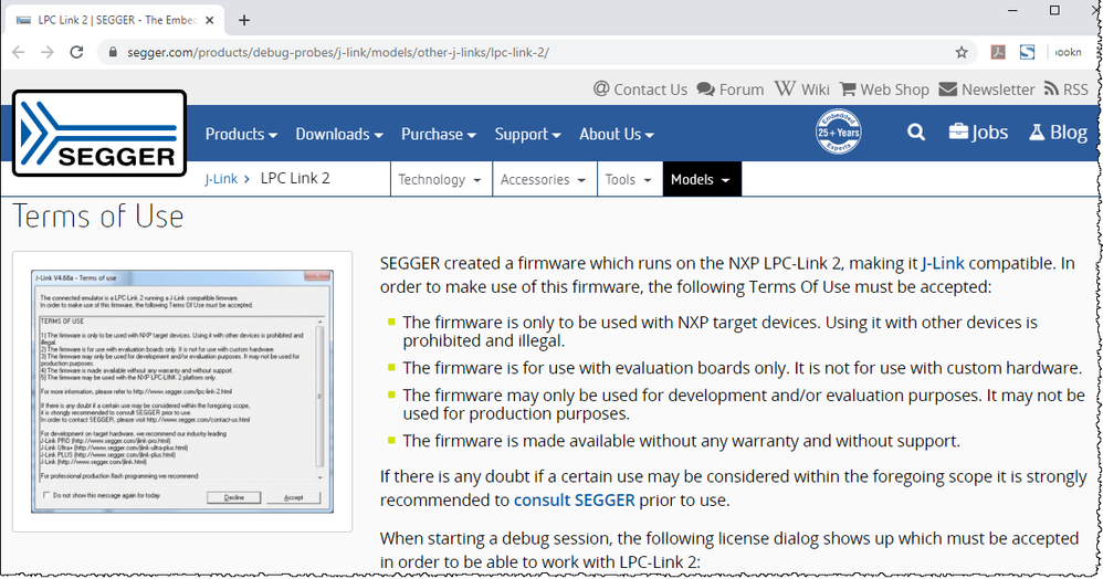

When LPC-Link2 is program_JLINK firmware, it was able to program S32K118EVB. But the firmware is for use with evaluation boards only. It is not for use with custom hardware.

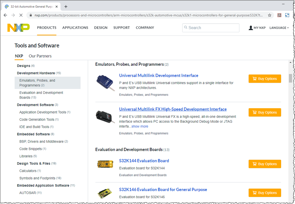

Emulators, Probes, and Programmers

You can find tools at Emulators, Probes, and Programmers.
P&E Multilink Universal
P&E Multilink Universal FX
See also:
IAR i-jet
Segger J-Link
Lauterbach
iSYSTEM iC5700
