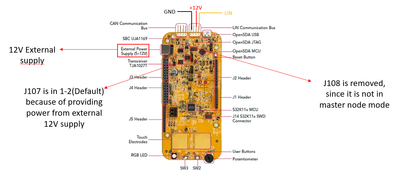

I did the following hardware configuration:
* Connected 12 V external supply and changed jumper J107 to 1-2(Default).
*Removed jumper J108 as it is in not in master mode.
*Connected lin bus line, Gnd and 12 V for lin communication peripherals for NXP EVB as shown in below image.
Please let me know if there is anything else I'm missing out.
Thanks & regards,
Santhosh
5,876件の閲覧回数
PetrS
yes, it looks correct.

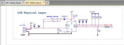

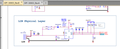

check board schematic. You can measure test point TP521.
On revB board /SLP is pulled up and not connected to MCU, nothing to do
On revA board is not pulled up and is connected to PTA7 which should be held high then
BR, Petr

better to check SLP on transceiver, so TP521.
TXD is output from MCU, so there will be signal just when slave (MCU) is sending its response.
RXD is input to MCU and if transceiver is active it follows LIN bus signal. So if transceiver is working you have to see same signal on RXD as it is on LIN.

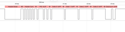

6,045件の閲覧回数
santhosh23
Also, the other signals from master node is as shown below.
For 0x01:
For 0x00:

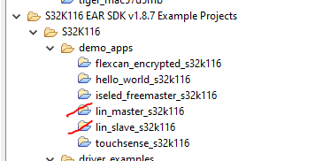

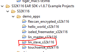

I tried with the both examples below .
1. lin master
2. lin slave
I couldn't send any signals nor I recieve any. Is there any settings or configurations that has to be made with hardware such as setting jumpers properly or something else before trying this examples?

PetrS
if you need to use LIN stack then you need to refer to SDK or RTD demo examples. SDK or RTD offers LIN driver demos as well. It would work normally. Boards have to be powered by 12V and master board must have MASTER jumper placed. You should be able to measure LIN frames on LIN line and TXD,RXD pins.
If you would like to have some slave baremetal code, maybe below one can be useful as well
 https://community.nxp.com/t5/S32K-Knowledge-Base/Example-S32K116-LPUART-LIN-Slave-TXRX-ISR-S32DS-ARM...
BR, Petr
