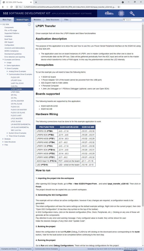

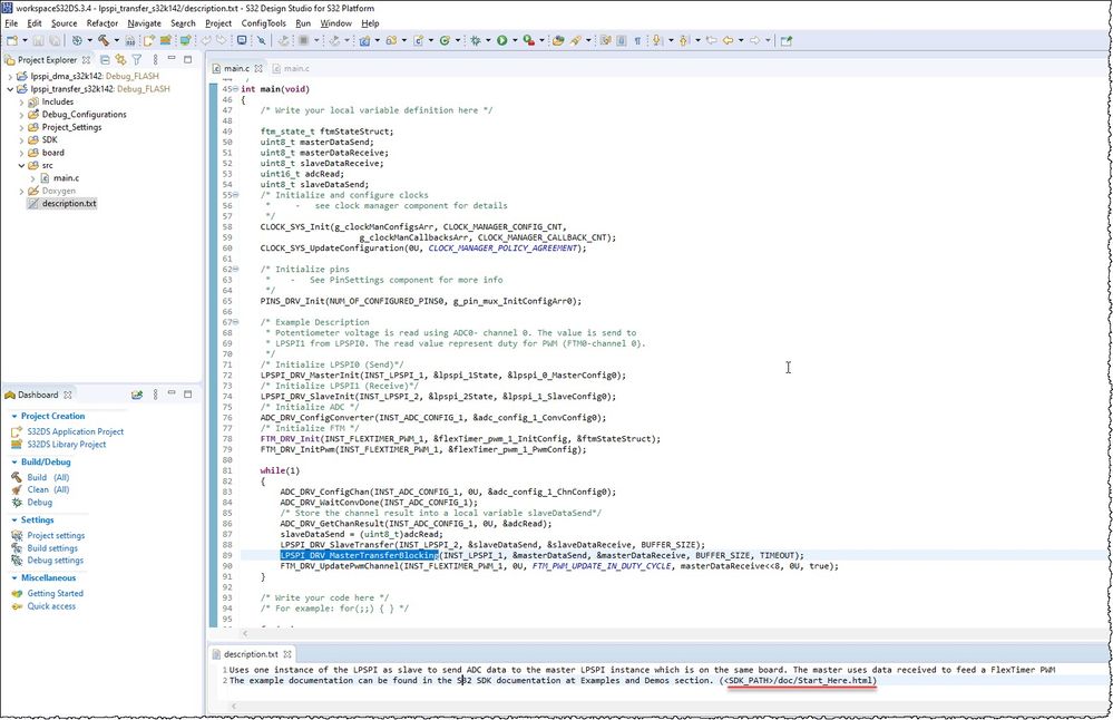

Please refer the SDK example lpspi_transfer_s32k142
The example documentation can be found in the S32 SDK documentation at Examples and Demos section. (<SDK_PATH>/doc/Start_Here.html)
You can follow and test it on S32K142EVB.
