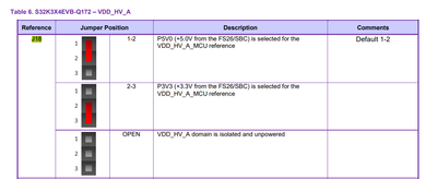

But when I make the J18 jumper open, all D1, D2, D4, D5 LEDs starts glowing and the TP26 shows 5 V in the oscilloscope.

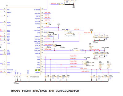

Could you confirm the voltage supply in FS26 when J18 is in 2-3 position? This should return the 3.3v value. By removing J18, no voltage should be active for the VDD_HV_A domain, as stated in the Hardware User Manual:
Also, please help me going into the Hardware Design resources, and confirming the voltage connections for LDO1OUT1/2, in case of any burned components before the FS26ZZXMA0D.

When connecting the J18 in 2-3 position, J427 gives nearly 0V. Which is similar to what was happening when J18 was in 1-2 position, J427 was 0V.
But when I open the J427,
1. VDD_HV_A = 5V for position 1-2 in J18;
2. VDD_HV_A = 3.3 V for posotion 2-3 in J18 (voltage measured from pin 2 of J427).
3. D3 RED LED of RESET_K3 starts glowing for positions 1-2 and 2-3 of J18.
I think the problem is due to the pin 1 of J427.
I didn't understood your second point but, J25 = 5V and J27 = 3.3V meaning LDO1OUT and LDO2OUT are working properly.

Could it be an accidently shorted signal? Like the VDD power supply to the GND.
J427 is responsible for voltage supply in VDD_HV_A, if there has been any overvoltage or shorting, I'm afraid there is not much that can be replicated from our side, I apologize for the inconveniences this may cause.
