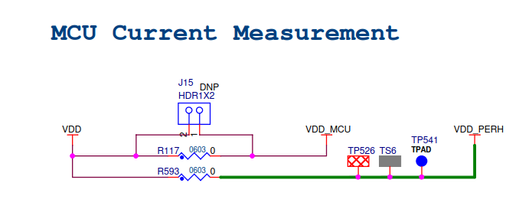

Nibesh
Hello @danielmartynek
J104
2-3 (Default)
Reset signal direct to the MCU, use
to reset S32K146.
J107
2-3 (Default)
S32K146 powered by USB micro
connector.
J10
2-3 (Default)
VDD voltage is connected to 5 V
My Connection is like this @danielmartynek
Which pin should I take for VDD if my VDD is 5V?
I have attached Pic for your reference
2,262 Views
danielmartynek
You can use J15, it powers the MCU regardless of the USB/12V, 5V/3V3 configuration.
