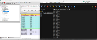

I already can launch group with core0 and core2 according to the following picture, the left side is run on core0, and right side run on core2.
But core2 can't run after I power off and power on the device. Only can run in debug mode.
Is there anyone has experience or idea about this?
The attachment is my main.c file, I also add the following code into the main function.

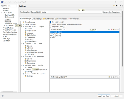

Also, have you included the defined symbols for multicore functionality?
Julián

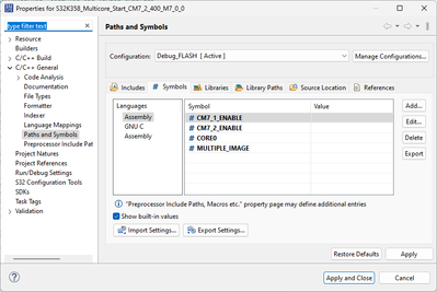

The picture you've shared cannot be seen clearly, but I see you are not using S32DS. Have you tried the example project shared in the community? S32K358 Multicore Start CM7_2 from CM7_0 - NXP Community.
It configures CM7_2 both through the MC_ME register and with the Power component. Below is the function for starting the second core (which I can see it is the same as the one you've shared) start_core_cm7_2:

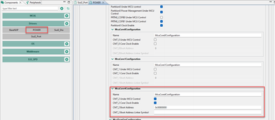

You can look over at the power configuration for the second core through the configuration tool's view:
