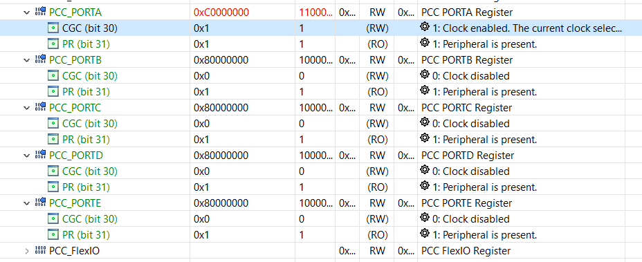

Hi.
I'm facing with a trouble.
During my Debug activity with IAR EWB 8.42 for ARM, I found that PORTS initialization fails on two specific ports: PTA and/or PTC.
The other three ports initializations are OK (PTB, PTD, PTE).
In details, the emulator used (J-Link Ultra+), is redirected to a DefaultISR (Reset) because it tries to access to a "
Port C control (address 0x4004B000)",
" but in the memory window, it appears like an unavailable data. Why?
Maybe the S32K116 definition file used by IAR EWB - J-Link is wrong?
Below a picture of a setup of mine:
Is anyone able to give me an escape way?
Many thanks in advance.
Claudio Ampala
1,854 Views
danielmartynek

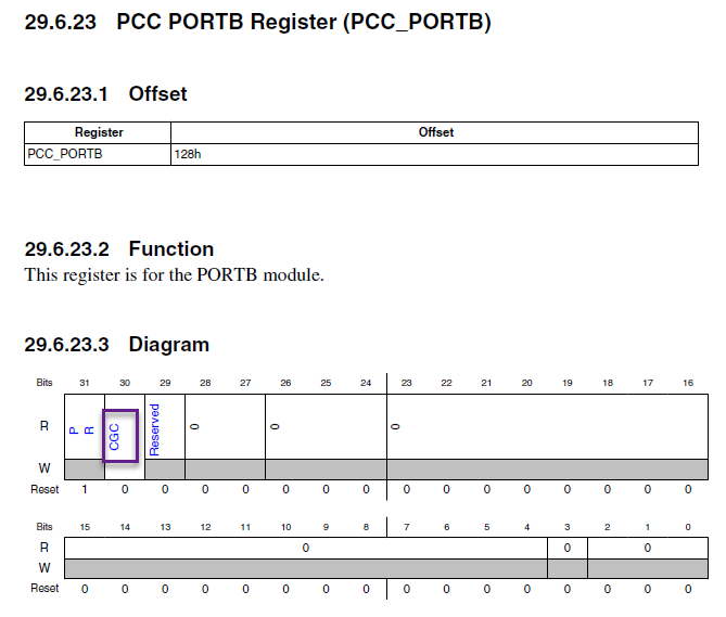

Hi claudioampala,
Please make sure that the PORTn bus interface clock is enabled.
BR, Daniel
